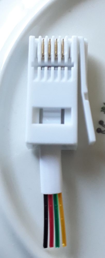

Re: Can't get DV to work with new RJ11 extension cable to corded phone
Here a plug I made earlier i.e BT431A
A cut off plug from new leadA cut off plug from new lead
@HHGTTG  Very nice but isn't it going to be a bit short when you put the plug on the other end?  (Ha Ha).
Anyway, you should be able to glimpse the colour of the wires through that slot behind the pins.

Message 39 of 41
@WSH
Well I find very difficult seeing the colours in situ. Perhaps a magnifying glass would help. I have another cut off plug with different colourway.
