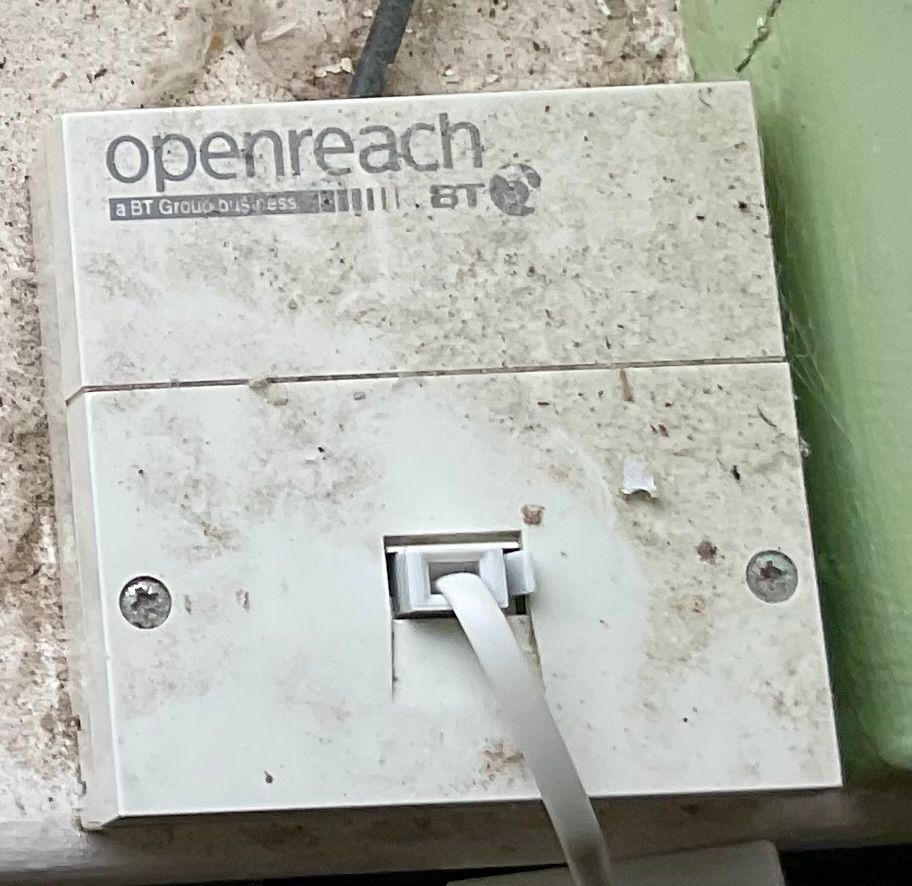

Into the flat.Into the flat.
here is my plug by the window and also my home phone.

The socket in the photograph is just a phone socket which suggests it is either a slave socket with the master socket elsewhere, or one into which you have a microfilter fitted to split phone from broadband. If the problem is not resolved with using a normal phone it might be worth try a different microfilter (assuming you are using one) or trying the phone in the master socket. If the master socket has a removable faceplate also try removing that and plugging the phone into the internal socket to see if that makes any difference.

the socket is the main one coming into the flat. Yes, there is a micro filter and I unplugged it, to connect an old phone direct to the socket.
I have tried it with the micro filter and the noise is still there.
thanks so much.
kind regards John.

Sounds like an earth contact fault. Have you reported the fault to BT, a line test should pick it up.

I agree with @licquorice  there is one more thing you might want to try and that is a quiet line test (dial 17070 from your wired phone) and if there is any noise then report that as it should be completely quiet other than announcements every minute or so.
