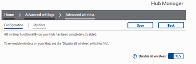

Same here, using ASUS AX86U as main router with SH2 simply passing wan connection and providing DV. Everything on SH2 disabled with exception of firewall. A handful of specific ports being forwarded.
Sky Q is connected via lan cable but its WIFI is on channel 36 along with my router WIFI broadcasting on same channel.  Sky Q mini boxes as well. I have no issues.
On the SH2 (with latest firmware),  you disable can disable WIFI fully which now includes the backhaul connection used for BT wifi discs and more.  This should then rule out SH2 wifi causing problems with your Sky Q box.
However, I fail to see why Sky Q would reboot if there was any kind of network issue. You sure it's not the Sky Q box that is the problem / developing a hardware fault that is a causing a reboot now and then?
