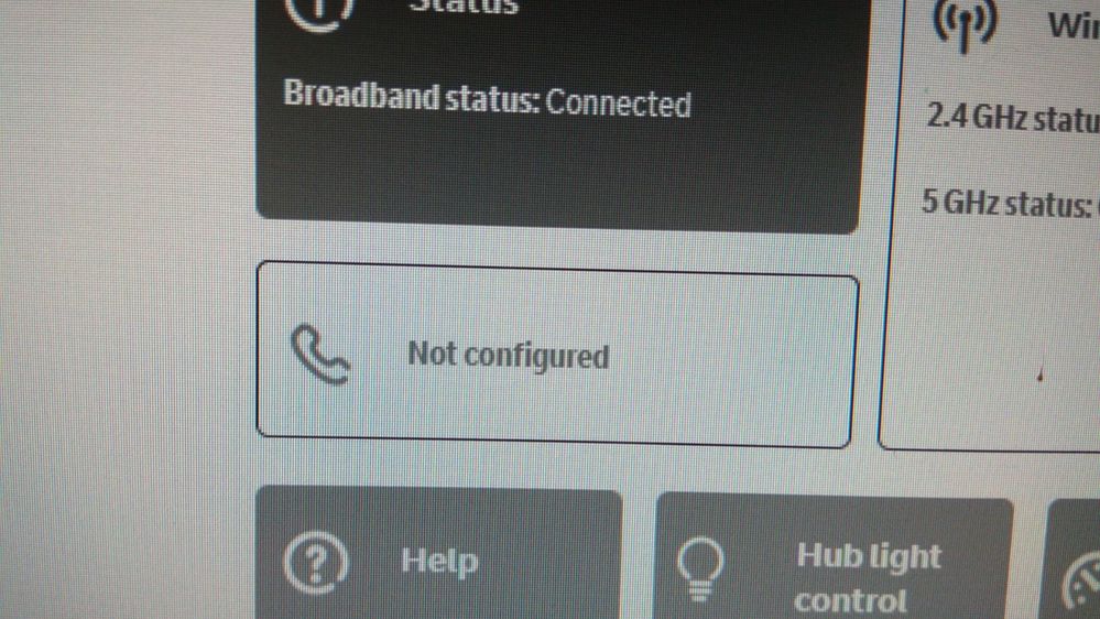

Finally got through all the autobots etc, now awaiting an advisor to call..... This is what my hub is showingWhatsApp Image 2022-08-08 at 3.22.46 PM.jpeg

FW update has upset / damaged the router.... it is showing a red flag at their end... new router being sent out
