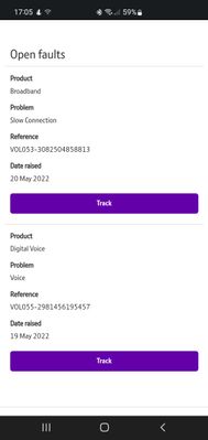

Just looked at my faults and i have a new one now for broadband saying the engineer has been and fixed it🤣 the original fault still says engineer was due to fix on 24th
