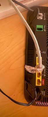

Hi, thank you for the response. In gonna attach a picture of the back of my sh2. As you’ll see the wan port is there hence 3 Ethernet and 1 single wan port. So would it be safe to assume that my black discs still work with this hub after the upgrade? But i may have to relocate them depending on where my hub is at right?  Currently my hub is in my converted loft with my bttv box and i want to keep this location which means they will have to install the ont box on the outside wall at ground floor level but to connect they will have to run whatever cable (I’m assuming Ethernet cable)? To my sh2 upstairs through the bottom of the window or straight through the wall whichever easier for them. But i need to know if they will run the cable from ont to the back of sh2 at loft level or not because the loft is where I’m at as their customer
  • Ps it’s not allowing me to attach pictures of back of my sh2 but yes it has a wan port
does your existing phone cable come from pole and attach to bracket at roof level?
the CSP is the box on outside wall and the ONT (fibre modem) is fitted internal and needs a power supply ont-pon.jpg
