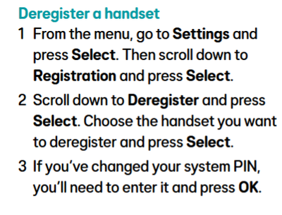

Surely you deregister the handsets from the handsets not the hub.

Re: Home Phone Plus will not connect to Home Phone Adapter
Go to solution
@Graham1999
https://ee.co.uk/content/dam/help/user-guides/ee-home-phone-plus-userguide-v2.pdf
You're only option to use the new handsets is to relocate the SH2 in a more central location.

Thanks rbz5416.  I'd just worked this out, and was about to confess.  Many thanks for your help.
