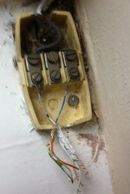

@Anonymous
"Presumably at that point you where dealing wholly with BT phones, which IIRC back in the day had captive leads."
Yes, up until that time the GPO / British Telecom had a monopoly on supplying telephone equipment connected to their network. All residential and small business customers, (subscribers as they were called back then), would have had a terminal block like this one, that hard wired their telephone to the incoming line. They were not allowed to interfere with this connection. Some people may still have this type of block, to connect the incoming dropwire from the pole, (grey in this photo), to the thinner internal cable running to their master socket.
