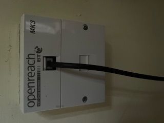

There’s no lights on the socket. I’ve tried to attach a picture.
Full fibre is switch on on the hub manager.

That's Part Fibre (FTTC), not Full Fibre (FTTP), so ignore my two suggestions.

Shouldn't matter whether it's on or off with Part Fibre. *
Again, it shouldn't make any difference in this situation but if you have a suitable cable you could try connecting the phone socket on the wall to the grey DSL port on the back of the hub.  (The grey DSL port is the one it's already using).  The filter at the top of the wall socket was really just to filter the old voice.  If it's faulty, using the telephone port should work.
Edit: *Although, if you have the PC connected to port 4 it wouldn't do any harm to try it on another port.
