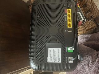

The router is working just not connecting to internet. It is either flashing pink or sometimes flashing orange. I am in the house with them. I have checked all the obvious things - wires etc. This is why it is so infuriating- there is clearly something weirder wrong, or something we’re missing, or some mistake that has been made. I just want BT to look into it as a matter of urgency. Open reach shouldn’t be allowed to leave things not working (as a result of their actions) and not be obligated to come back to fix the problem as soon as possible. It’s causing great distress to my elderly mother and I’ve had to take time off work to try and help sort it out.
I’ve attached photo of router - does all look ok

TBH , as you were not there at the time  , it’s conceivable that the broadband was working , the advice to give it until midnight for the phone to migrate to DV , and it’s a coincidence that a fault has occurred so soon after visit  ( the tech that did the visit had no reason to enter the external network or even the internal wiring inside the home so difficult to see how the two things are linked)
I’d agree that , given the broadband is off and you have presumably checked what is easily checked , the power , the DSL connection lead , and filter ( if a filter is used ) that a return visit is needed , but that will be via the normal faults channel.
Did the tech change the master socket to one with an inbuilt DSL filter ?, if not then I doubt the tech that visited had anything to do with the current situation, if the socket were changed , it may be something to do with that (so potentially disassembling it and reassembling may rectify the issue )

Ok, this a long shot, I wonder if the socket is incorectly wired.
Before the move to DV were the phone and router plugged into the lower socket via a filter rather than phone in lower socket and router in upper socket? If so, restore the filter to the lower socket and connet the router to it. Its extremely unlikely to be the cause but there is a small possibility.
At no point have you confirmed the technician demonstrated a working system before leaving, did he/she?
