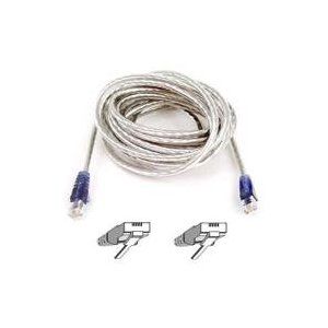

Re: Preventing landline crackling
Go to solution
something like this maybe amazon

I believe that you need to ground one end of the shielding, but I can't be 100% certain of the details, so you should probably check that - it may mean that the socket at one end needs to be of a higher spec (i.e .groundable) too.
Note that the cable illustrated above is a data cable with rj45 plugs and not a pure telephone cable. Not sure on he details of your telephone cable, if it is  BT cable to the master socket, an internal extension cable from master to save socket or a data cable.
