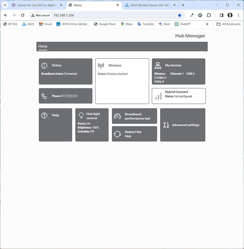

Message 24 of 37
Re: Use SH2 for digital voice and Asus router for wired / wifi internet
Go to solution
I have no idea either.... but I'm really glad I can do it  😉
As you say
BT SH2 is one network: 192.168.1.1 to 192.168.1.254
ASUS is the sub-network: 192.168.50.1 to 192.168.50.254
In my browser 192.168.1.254  logs me into the BT SH2.  See screen shot below
All I need is the hub password to get into the Advance settings area
In my browser 192.168.50.1 logs me into the ASUS panel.  (192.168.50.1 forwards to http://www.asusrouter.com/ )
4,053 Views
Message 25 of 37
Go to solution
