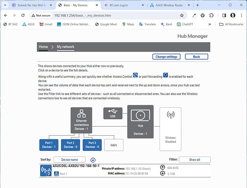

That's essentially what I have done (I think)
The WAN port assignation on the ASUS DSL-AC82U is slightly different as you can reassign the WAN port whereas on the ASUS DSL-AC68U I think you had to assign one of the existing LAN ports as the WAN port.
BT SH2
left as default the IP address: 192.168.1.254, subnet mask: 255.255.255.0, DHCP server set to: NO
ASUS DSL-AC82U <- IP range out of the box for ASUS was different from BT SH2 so didn't have to change defaults!)
The out of the box setting was IP address: 192.168.50.1, subnet mask: 255.255.255.0
LAN-DHCP Server, IP Pool Starting Address: 192.168.50.2, IP Pool Ending Address: 192.168.50.254

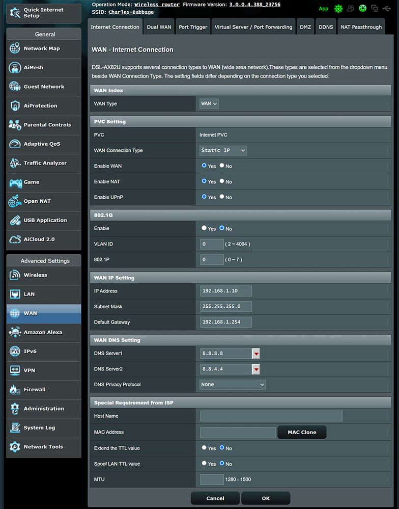

WAN | Dual WAN | settings changed from default DSL to WAN
WAN | Internet Connection | as a result of changing settings above from DSL to WAN. Key changes here was to set set the WAN connection type to: Static IP and define the WAN IP settings, IP Address: 192.168.1.10, Subnet Mask: 255.255.255.0 and Default Gateway: 192.168.1.254 (see previous image)
The only thing I have not done in the BT SH2 is to setup Port forwarded all IPv4/6 traffic to 192.168.1.10 nor put the ASUS in the DMZ.
BT SH2

GOOD news I have a working solution.  BT SH2 ->  ASUS DSL-AC82U
And the even BETTER good news is it ported over without me having to change any of the underlying setup of my existing network that includes WIFI AP in most rooms nor did I need to get the burglar alarm engineers to reset their setup which is linked to 192.168.50.XXX
Big thank you to @licquorice

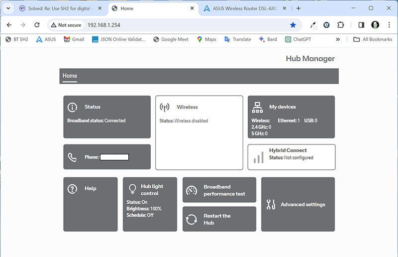

Hi I am having the same issue, recently upgraded to FTTP from FFTC. Home phone is now digital and am using an ASUS router. My question is : Did you actually manage to turn off the WIFI functionality of the SH2 ?? My past experience with the EE router SH2 for FTTC is that when setting the WIFI to off all it was doing was broadcasting and hiding the SID. It was regularly searching for a less used channel as evidenced by the logs. If the SH2 has WIFI off why is it searching for a less used channel ? that would be pointless and make no sense. I also used inSSIDer (a tool to see what wifi signals are around) from my laptop and there was a very strong HIDDEN network which appeared to be mine.
So using the SH2 in your current setup is the SH2 still broadcasting ? as there are a lot of signals local to me so don't need the extra noise to say nothing of the other **bleep** in the EE SH2.
