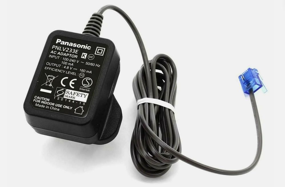

@licquorice thanks for replying. On inspection of Panasonic KX-TGC the 1 x main phone sits in a cradle with jack plug power supply and a small green telecomm connector plug showing 3 copper wires, it fits into the right hand socket of two on my BT 'Master Socket SC' on the wall. The SC left land socket goes to the separate wifi router. My 2 x remote Panasonic phones each sit in a self recharging socket and connected via similar small green telecomm connector plugs to the wall. I can see 3 copper wires in the connectors. Lifting one of the remote phones or unplugging the telecomm connector gives a tone. I am at a loss to say if 2x remote phones are wired or wireless, certainly once a call is picked up you can wander about & don't lose the call connection, so the handset itself is wireless? But I'm not so sure about the link. You can use the 3 phones as a small direct inter comm system when the system is free i.e. when not taking a call.

@arsie1
You seem to be confusing the power connections for the remote handsets. They appear to use a variation of the RJ11 phone connector but do nothing but carry power to the cradle.

@Anonymous I admit to being easily confused! My remote cradles are labelled 'PNLC1042 battery charger output 4.6v'. So are remote handsets wireless as such? And will they continue to function even after BT remove the land line? Likewise the inter comm capability?

Go to solution
Yes they're wireless & as @imjolly said in post #3, they will continue to work as before. once the base is plugged into the Hub.

The Panasonic kit I have is KX-TGC210E which comprises 1 x handset plugged into the BT master socket, it's wirelessly connected to 2 x remote handsets sitting on cradles connected to low voltage  connectors, the end plug being an RJ11 (hope I got that right) which looks like BUT ISN'T a telecomms connection. All it gives is power, being used to charge the handset in the cradle. Remote BT phone sockets were just in my imagination though might have been there originally.
