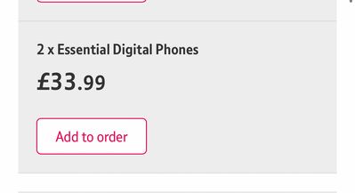

hi, we just got full fiber 500 and i just found out you cant put the bt smart hub 2 on bridge mode. would i be able to plug the phones into my 3rd party tp link wifi 6e router?
 these are the phones we are getting, theyre voip phones but not the alexa version, please help thank you

You don't plug them in anywhere, they are DECT handsets which only work with the Smart Hub 2.
If you want DV, you need to use the SH2 as the first device connected to line.
Even if the SH2 had a bridge mode, it wouldn't help as it wouldn't have access to the IP layer in bridge mode.

so i have to get rid of my tp link and go back to wifi 5 smart hub if i want to keep the house phones?
11,091 Views
Message 4 of 10
Re: using bt phones with a 3rd party router
No, you can still use your TP link in access point mode connected to the SH2
