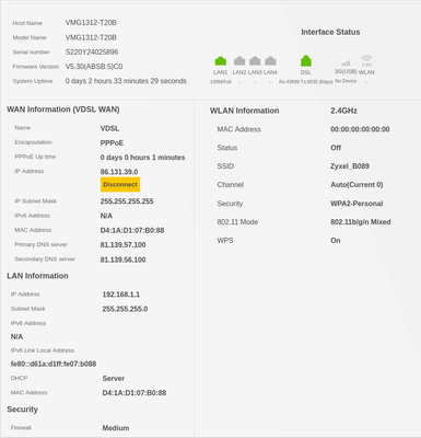

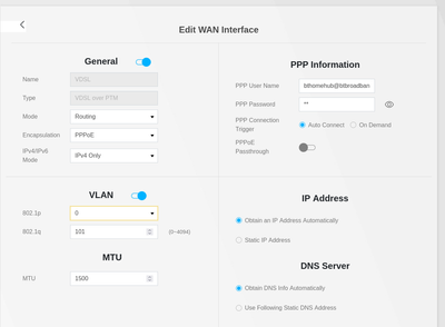

Hi,
I know this type question has been asked a few times but I'm totally stuck. I'm trying to setup a zyxel VMG1312-T20B. But while it will connect I'm getting speeds of around 1Mb. And the connection is unreliable. I've set it to PPPoE, the vlan to 101 and the login to [email protected] password BT. I've reverted back to the smart hub and all is working as normal.
Added a screen shot of the the settings page.
Many thanks!

@dan515
Did you run a setup wizard - if Zyxel have one - or did you set up manually?
The MTU is usually 1492 not 1500 btw.
Is there another setup screen rather than just the General one?

I did go through their wizzard. Not much to set in there. Just region and WiFi stuff mainly.
There is an advanced DSL settings page, but it's mainly just toggles for protocols. I'll try and grab a screen shot.
In terms of status, it's reporting roughly 44,000 Kbits up and 7,000 down. Which is about what I see on the BT router.
