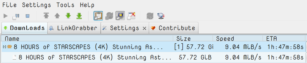

JDownloader sample ⬇️
I have a laptop that achieves 800+ with the same cable in the same socket, so I know it's something to do with my desktop, by logical elimination. Theoretically I should get a max of around 112 MiB/s for my 900 package.

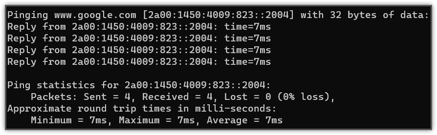

I've no idea if this is any good:
M.

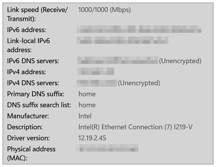

Check that your desktop Ethernet card is actually connecting at Gigabit speeds. Its not unknown for auto negotiate to fall back  to lower physical connection speeds, especially on a long cable. It can also cause it to toggle between full and half duplex, which will slow things down.
The download speed you are getting would indicate 100mb actual Ethernet speed.
Hardware variations can result in the Ethernet Link pulse getting corrupted. You may be able to overcome the problem by adding a 1Gb Ethernet Switch between the end of the cable, and the desktop, as that should correct any timing issues.

When you talk about half anf full duplex, do you mean this:
I tried full duplex 1gb just too see. It was set to auto negotiate already. No difference.
I'm guessing that possibly just leaves an error on the nic on the motherboard. I can pick up a card for pennies really on Amazon. Unless of course I'm missing some other possible esoteric settings somewhere.
