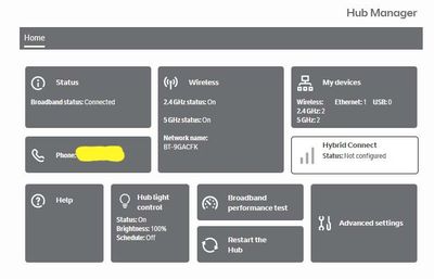

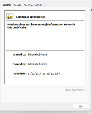

I am using Window 11 version 23H2.I have FFTP broadband supplied by BT, due to not having a static IP address I have been using https://www.noip.com/ to allow me to connect and view my IP webcam. When I use an open port checker  https://www.yougetsignal.com/tools/open-ports/ this confirms that the port concerned is open. This allowed me to view my webcam via the internet from anywhere, this worked OK until recently. When I now use the noip link, I end up at my BT router home page and do not now connect to my webcam:
I can connect and view my webcam using my mobile but not by using any Windows PC’s. I believe that the issue is caused by the BT Certificate which prevents windows allowing me to view my webcam.

You would not be able to connect to your external IP address from within your home network, as NAT Loopback is not available on the home hub, so you will simple be redirected back to your home hub.
You would need to access your webcam using its own local LAN IP address, or by using a device connected to a different network, like mobile data.
You can ignore the certificate error when connection to the home hub web interface, as its not a https connection.

You're trying to access over HTTPS (which is why you see the certificate error). Chrome recently updated to automatically try HTTPS before HTTP - I suspect this is why you're seeing this issue now. Try manually changing the address in the address bar to http:// instead of https:// and I suspect it'll work OK.

When you access your camera remotely, you will always see a certificate error - that's unavoidable I'm afraid, as the camera will be serving an internally-generated certificate that your browser can't trust.
