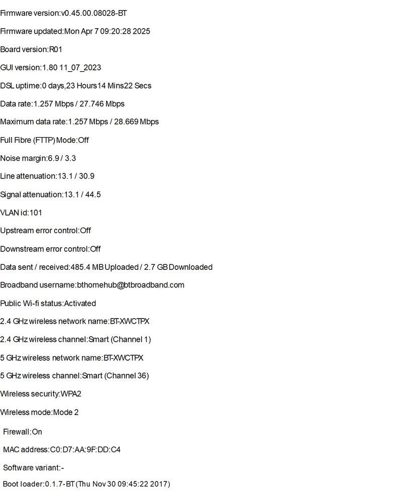

@imjollywrote:
@smiler44
@licquorice   told you in post 10 where to find the stats to post
You need to post the stats from hub manager> Advanced settings> technical log> information

Your broadband had a disconnection 24 hours ago, if that is a regular occurrence it is where your problem lies.
Look in the technical info logs and filter on WAN, look for DSL down events. I suspect you will find multiple entries.

There are multiple pages to the log (about 200 odd)  you need to scroll through.
Your uptime was only just under24 hours, ergo there was a disconnection.

Thanks. Is this what I should be looking for?  Filtering as you say, there are 37 pages, not every line says what is below.
DSL Link Up: Down Rate=27251kbps, Up Rate=1144kbps; SNR Margin Down=3.2dB, Up=6.0dB
a bit more scroll through the pages and I found this  DSL Link Down: duration was 60005 seconds
have now found this DSL Link Down: duration was 596 seconds
Can you advise what this means please?
