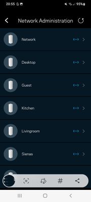

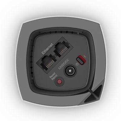

Thanks for your reply the linksys mesh routers have rj45 but no wan for what I know
I have no idea about the linksys devices, but if they don't have a WAN port, there would be no point in a bridge mode for the SH2 in any case.

Are you sure one of the devices is a router or are they just mesh wireless access points.

Each node is both a router and an access point using the same ssid and one set as the parent
