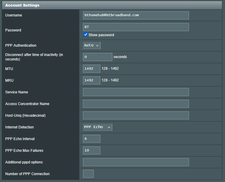

The WAN section of the settings on the Asus router should look similar to:

I have reset the router and done the set up again.
This time I was offered a firmware update.
Once that was done everything worked fine.
