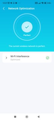

Have you run the network optimisation option on the Deco app?

Thank you (and @naylor2006)
I have just run the optimisation, following your post.
