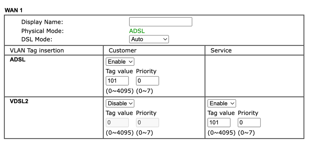

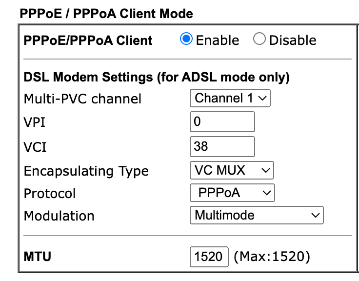

Got BT Fibre 100 with Smart Hub 2 at the moment and I would like replace it with Vigor 130 (later Vigor will work as bridge which will be connected to pfsense but at the modem it will be as modem only).
I cant connect magange to have connection.

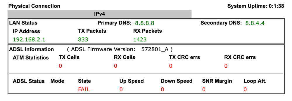

Online Status > State is in a loop TRAINING > READY > FAIL
I use latest BT firmware. Tried older BT and non-BT firmwares and with the results.
Any idea where is the issue?

I think you need VDSL not ADSL.
Edit: In fact, Fibre 100 must be FTTP?   Not sure the Vigor 130 can do FTTP.

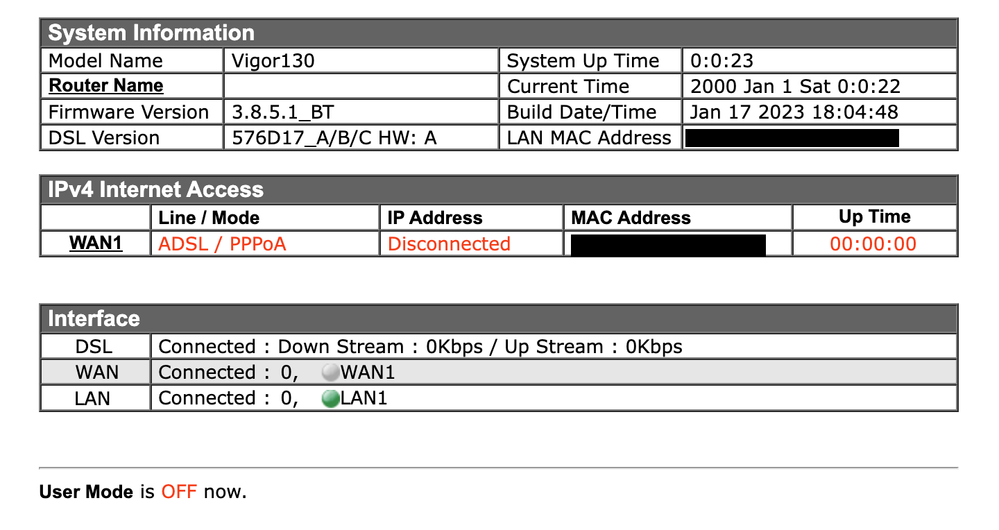

If you have FTTP the ONT is a modem. You don't need the Vigor to connect to your PfSense amd you can't connect 2 modems together in any case..
If you wish to use the Vigor as a router (why????) then you need to connect the ONT to the WAN port.
If you have G.Fast, the Vigor isn't G.Fast compatible and won't work.

I seem to recall the 130 is only a DSL modem.  It doesn't have a WAN port and I'm also pretty sure it doesn't do routing.  If this is FTTP then it's probably better employed as a paperweight.  Might be wrong, of course, as I've never used one.

I dont have FTTP.
On the wall/box socket says G.Fast so it looks like Vigor 130 is not compatible with G.Fast
In that case any suggestions what modem to get?
BT Openreach MT992, Vigor 166?
