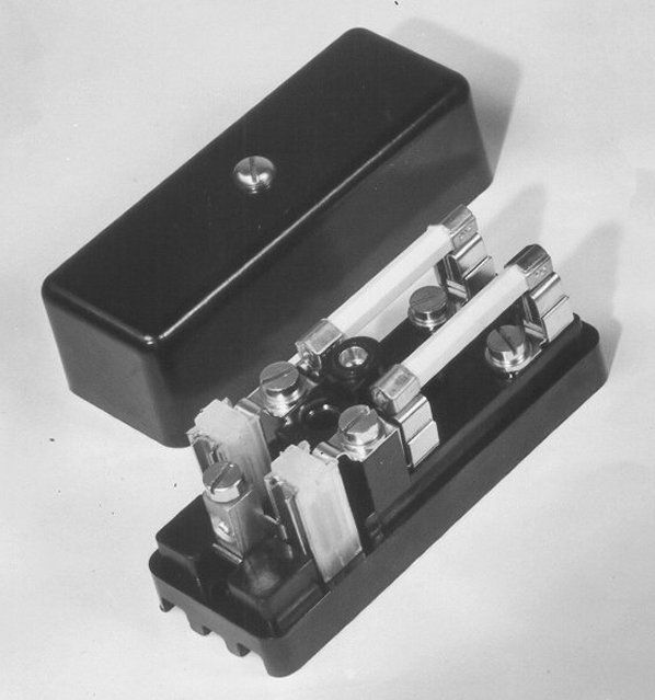

Are you sure it is associated with your phone line and not your electrical supply?
I can't imagine where it would be terminated (if it indeed it is actually connected) unless you have a connector block like the picture I posted.
If it is definitely associated with your phone line, just cut it or disconnect it from wherever it is terminated.
