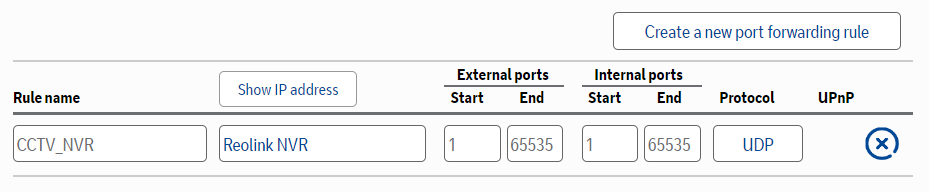

I am trying to set up my Reolink CCTV NVR for remote viewing while I am away from my house. In the house using wifi everything works fine. Remote viewing did work fine with a previous router (Vodafone) and required no changes to any settings. Since changing to the BT Smart Hub 2 I have not been able to view anything remotely.
I contacted Reolink support and they replied that to connect to the NVR using UID (where I type in a 16 figure ID) I need to “please enable UDP port 0-65535”. After a bit of further searching I think this might be a typo as I found reference to ports 1-65535.
My issue is how do I do this?
I have gone to the firewall settings and added a new rule, called it CCTV, selected the NVR as the device (and made sure it’s IP and MAC are as expected) and then in both the external and internal start and end ports I entered 1 and 65535, I set the protocol to UDP and saved it.
I tried to view the cameras on my phone (after turning off phone wifi) and got “Connection failed”
I have rebooted everything that can be, and even temporarily disabled the router firewall, but still could not connect. Turned phone wifi back on and I can connect without issue.
Have I “enabled UDP ports” correctly or have I made some other rather glaring error?
I would be grateful for any guidance!

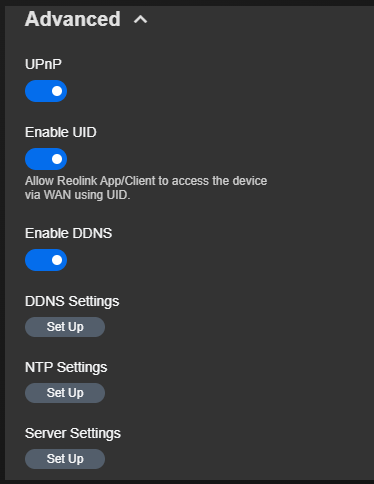

Hi @DarrenDev
The model is Reolink RLN8-410 and it has worked correctly and permitted remote viewing with a previous router - so my thoughts would lead to the settings on the Smart Hub 2 since that is the only thing that has changed.
However, yes it does have UPnP and it is already turned on (and always has been to my knowledge) - image of advanced settings attached.
Thanks

Message 6 of 15
Re: Enabling UDP ports for CCTV NVR
Go to solution
On your SH2, is UPnP still enabled? (Advanced settings > Firewall > Configuration)
8,104 Views
Message 7 of 15
Go to solution
Yes it is, and so is "Extended UPnP security"
