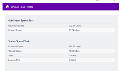

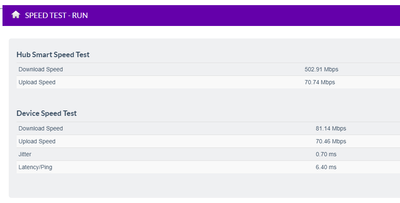

I've reached out to the support and their test tells them that the hub reach 500Mbps down and 60Mbps up so, for them it's all good. I did a speed test at a link provided by the support and this is the result:
Now, I'm connected via ethernet cable through a powerline that is, again, connected via ethernet to the Hub.
I tried already the basics (restart  Hub, Powerline and PC) but nothing change. The speed is consistently hovering around 80Mbps.

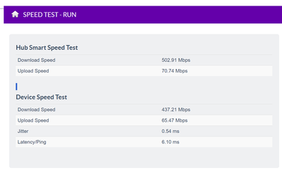

Connecting directly via ethernet to the router, confirm that we are getting the full speed as expected:

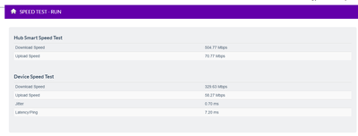

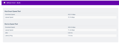

Just to add more tests:
Connected via ethernet to the Archer (which is connected via ethernet to the Hub2)
Same but in Wireless
So, I assume that as the signal strength and download capacity is more or less the same, I can connect via wireless but I'll prefer being able to be connected via ethernet and get the full capacity, especially as when the boost will ends, I'll probably go back to under 100Mbps.
