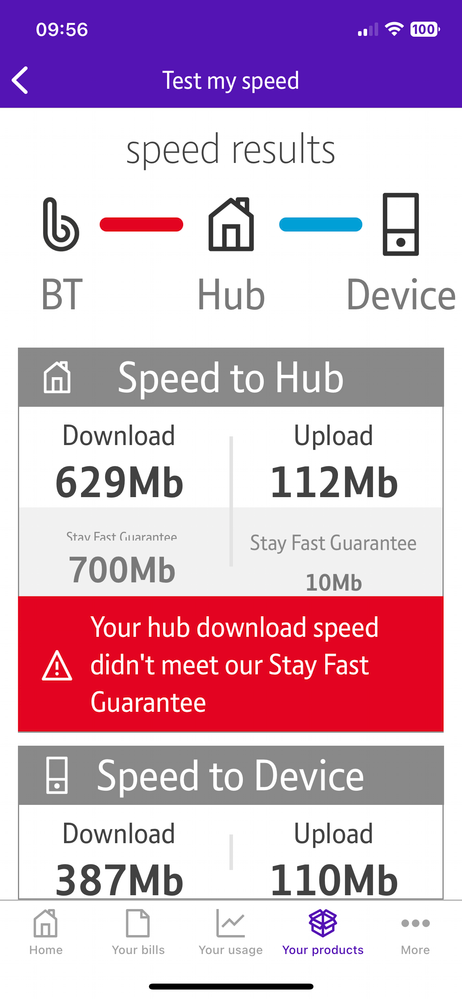

Indeed, it's just given me a speed of 1gig on Fibre 900, with speeds of 1.6 gig sometimes.
I find the Ookla Windows desktop pc app very consistent with speeds around 943 which are realistic.
The My BT app has just shown speeds of 605 down & 112 up with a message that my hub doesn't meet the Stay Fast Guarantee.
But hey, you'd have to be an AI robot to tell the difference.
