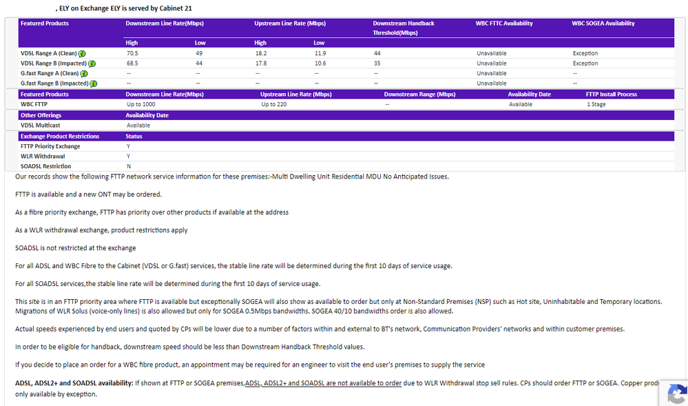

Is this the key phrase in the report?
"ONT exists with active service. A spare port may be available or a single port ONT may be swappable to a multiport ONT. A new ONT may be ordered".

Apologies.  I should've posted the report.  Also apologies, probably better as screenshot than text.

Yes, that means that fibre is already installed in the flats, you just need to place an order with BT.

Fantabulastic.  Thanks Keith.
