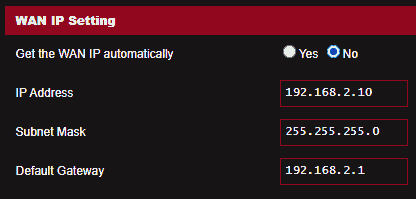

So it's probably best that you add in some settings so you can see into the modem configs & reports.
On WAN> Internet connection:  WAN IP
If you add in those settings you can get into the modem menus by going to 192.168.2.1 and get a better idea what's going on!
Whole house, garden, garage and half the street covered by a Flint 4 - WiFi 7 router

......as long as you configure your laptop manually to the same subnet.
4,415 Views
Message 20 of 32
Re: Gfast modem.
Go to solution
The modem and the router each need their own subnet.  So commonly that is 192.168.1.0/24 for the router, but the default on modern Asus routers is 192.168.50.0/24.  And then the modem will manage a 192.168.2.0/24 range.  Setting up the WAN IP this way creates a secondary or back channel to the modem.  Some routers do this completely automatically, others (inc Asus) don't!  Anything connected to the router can use DHCP to get its own settings automatically while still having access to the modem's subnet.
