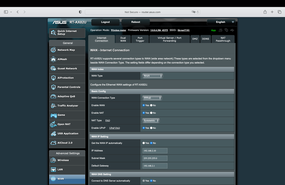

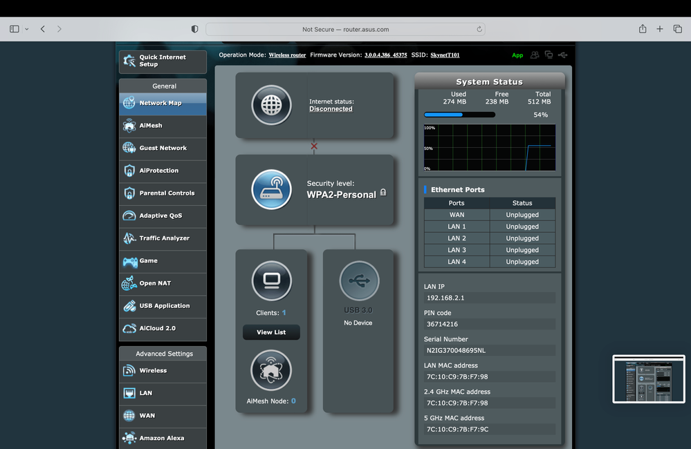

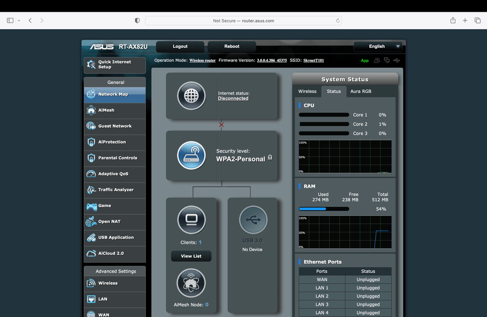

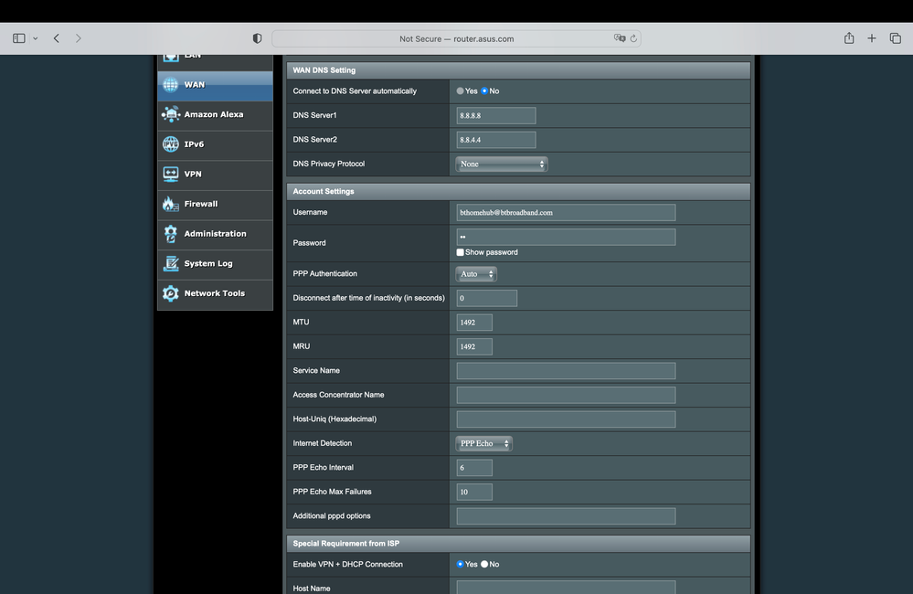

Afternoon. So I still can't get the LAN and WAN to talk to each other. Her is the screenshots

So, the obvious issue is that there is no connection on the WAN port.  Even if you don't have a connection to the internet the router should still be detecting the cable between the router and the modem!
