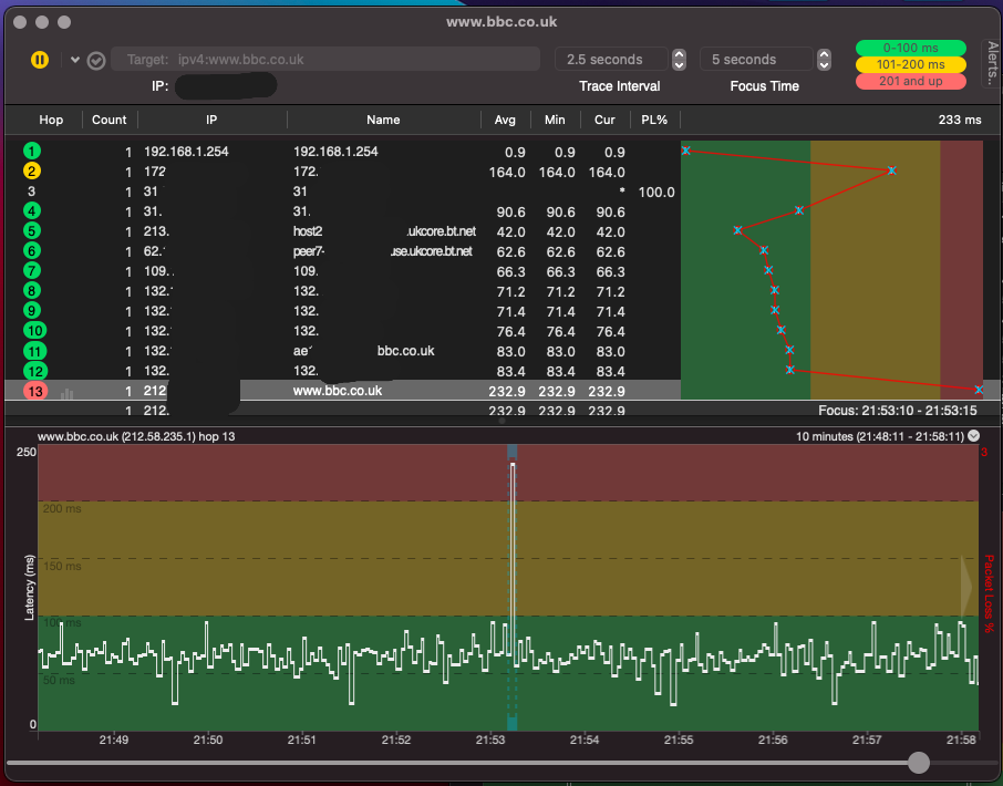

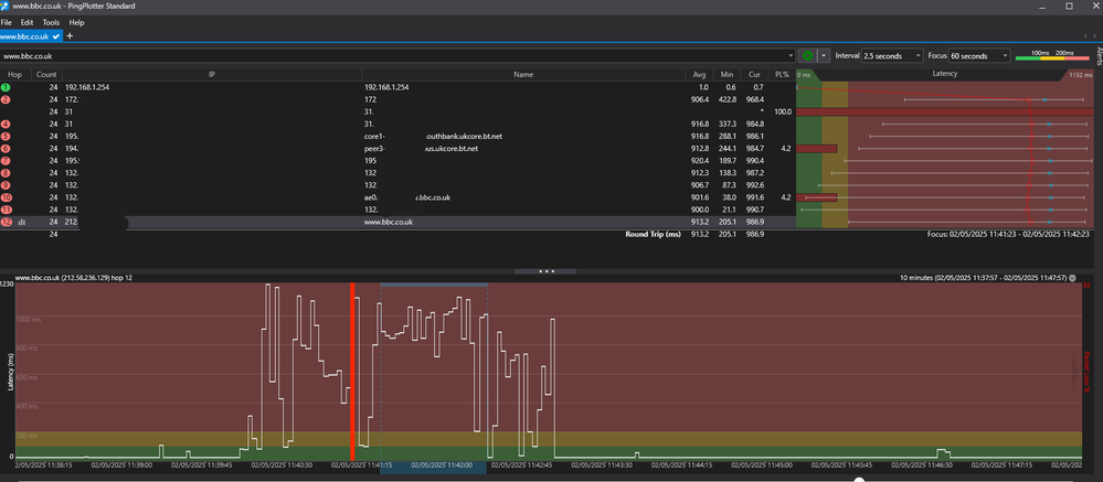

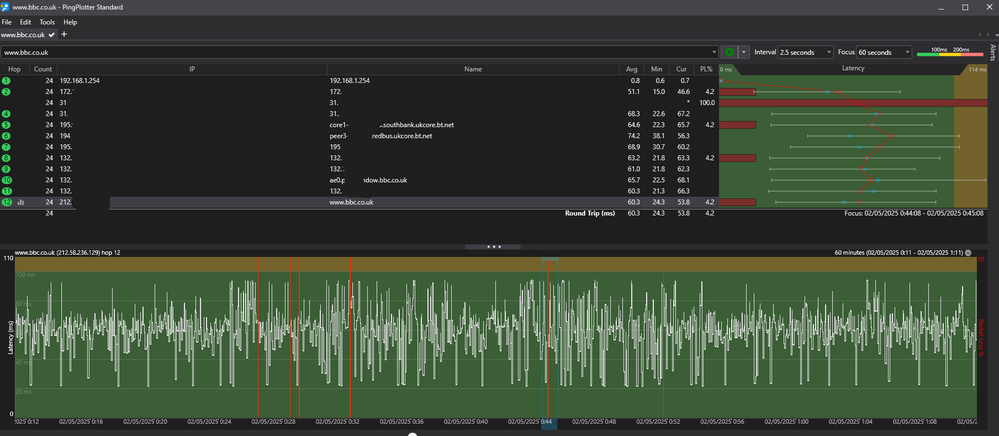

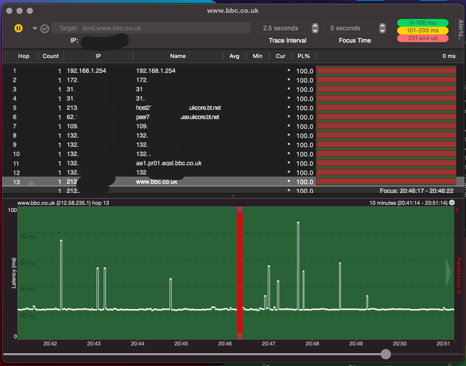

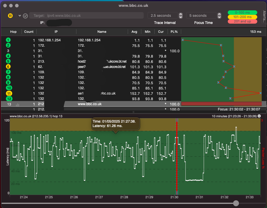

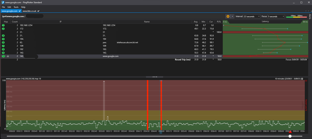

I was ready to leave for another ISP, but then thought there's no point in leaving if I'll have the same problem with another provider. To try and get any information to help. I did some monitoring using pingplotter on my PC. The PC is connected to a Gigabit switch which is then connected to the Smart Hub. To make sure the switch etc and internal house wiring wasn't an issue I connected a Macbook direct to the Smart Hub with a CAT6 ethernet cable. There's 3 screenshots from each with random ping spikes picked from the logs.
I've attached graphs below. Can anyone help identifying the hops?
Hop 1 - My BT Smart Hub. Hop 2 - would that be the local cabinet?
Many thanks

In most cases "PingPlotter" is the wrong tool, it has it's uses, but it's giving you some pretty, important-looking graphs that don't mean very much at all!
The important thing in all that data that you've posted is that you've a 900ms+ delay between your router and the first traceable switch within the BT network.  That would suggest to me that you have a device of some kind plugged in between your BT router and the ONT (on FTTP), or that there is something wrong with your connection between the wall socket and the cabinet (VDSL) or exchange (ADSL).
