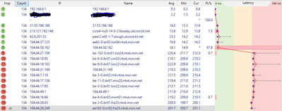

The past 2 weeks or so it's been going up to 200ms (as per the pingplotter picture I attached).

Looking at your pingplotter screen shot it would appear that you get through the BT routers fine and the first router on the MSN network fine but by the time you are routed through the third MSN router the ping time jump considerably.  Looks to me that it is an MSN problem rather than a BT problem - though it might be, as mentioned earlier, some agreement that means BT has to route through a certain MSN router that slows things down.
Have you tried contacting MSN with a copy of your screen shot?
