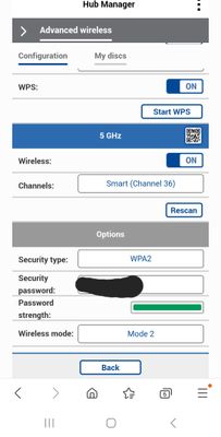

I have a smart hub 2 and cannot get it to link to sky Q on 5ghz. I want it to work wirelessly and its only about 3m away from the router going through 1 plasterboard wall. I have read some bits about sky don't allow it unless you have their router but other things about different channels in the hub manager. An engineer has just been out and he said its because its in mode 1 and mode 2 would make it work. (I tried that and it didn't make a difference.) Still on2.4 ghz. Anyone got any ideas if it's possible. TIA.
Picture attached if it helps

Sky Q uses channel 36 so you should change the hub 5ghz network to another channel say 48to avoid conflict.  I would also go back to mode 1

moving hub 5ghz network will not change the SKYq connection to your hub as it will be 2.4 but it will help if you have any mini boxes connected
