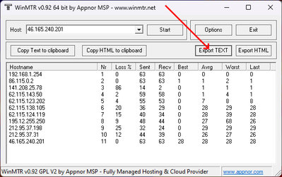

Here's how you can go above-and-beyond in providing useful data for BT and Crytek / LeaseWeb to work on this issue!
Helping BT and Crytek (LeaseWeb) Troubleshoot:
For best results, you want to download WinMTR. This tool combines the traceroute and ping utilities, giving you a much better insight on network behavior over a period of time. Crytek's community manager CRYIM#5562 has asked for BT customers to perform MTR tests and provide the results directly to him via Discord DMs on Hunt: Showdown's official Discord. LeaseWeb's instructions on how to do this can be found here (you want to use the game server 46.165.240.201 as the target for this).
To summarize the instructions, you need to:
  1. Download and install WinMTR.
  2. Launch the software.
  3. Select "Options".
  4. Change a couple of default settings:
    a. Set ping size to 8 bytes (This is the same size Hunt uses in ping requests).
    b. Deselect "Resolve names".
    c. Select "OK"
  5. In order to start the MTR, you need to:
    a. Set the IP 46.165.240.201 in the "Host" field.
    b. Select "Start".
  6. Leave the tool running for at least couple of minutes to generate enough data, five minutes should be plentiful. After you are done, select "Stop".
  7. Select "Export TEXT" to export the results as a text file.
  8. Save the results.
  9. Next you want to check what your public IP-address is. You can do so on website https://whatismyipaddress.com/. Save this information somewhere.
  10. Share the text file containing your results and your public IP with BT and Crytek.
    a. Crytek's community manager CRYIM#5562 asked for BT customers to provide the results and your public IP directly to him via Discord DMs on Hunt: Showdown's official Discord.
    b. Issue should be reported to BT via customer support, though they seem to be a bit elusive..
