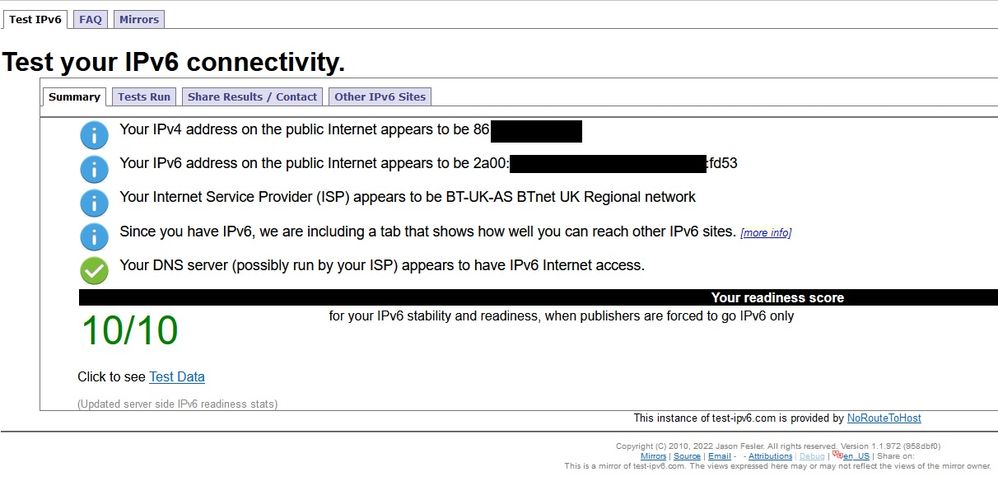

I don't know if this will help, but I have a secondary router connected to my SH2 via its WAN port.
For IPV6 to work I had to enable "pass through(bridged)" mode on the secondary router, on the IPV6 page itself, (NOT putting the router in bridged mode), and then reboot both of them.
When everything came back up I had full IPV6 support on my devices, my router even threw in an IPV6 Google DNS for me to make up for BT's lack of such a DNS!
So really it is just letting the SH2 handle all the IPV6 stuff as the primary router. Leave it on the default of stateless.
