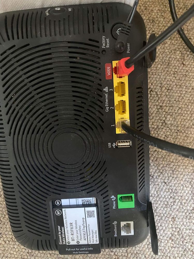

So this is what I have in the house, the ethernet cable in Port 1 goes to the garden room.  What am I missing?

Your ‘network’ should exist like this , Ethernet cable from the powered ONT ( where the fibre enters the house , I seems probable you are FTTP ) to the WAN socket  ( the 4th socket on the SH2 router ) the colour of the plugs on the cable doesn’t matter ) .
From any of the other 3 Ethernet sockets a Ethernet cable needs to exist to the network extension cabling your electrician provided, it’s been assumed that the cable is terminated on Ethernet sockets , one near your router and one in the garden room …obviously to make the cable to the garden room ‘live’ it needs connection to an Ethernet socket on the router , so the router has two Ethernet cables in it , one in the 4th port , for the ONT , and one in one of the remaining Ethernet sockets  1, 2 or 3 that connects to the cable to the garden room .
In the Ethernet socket in the garden room , another Ethernet cable from the Ethernet socket to the device ( PC, laptop  etc ) is needed to connect that device ( via the cabling provided by the electrician ) to the router , so in total you need three Ethernet cables …..what you have been asked to do is check all these cables are OK .
If the electrician has simply ran a cable with Ethernet plugs on it at either end ,  so no Ethernet sockets ,  and the cable end ( with a plug on it ) at the garden room is plugged into a PC/laptop and the device won’t connect to the router , then clearly the cable is not working .
