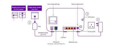

Then I have no idea, as I am not familiar with the EE hub, only the BT Smart Hub 2.
I have not seen anyone on this forum discuss the EE hub which I understand is different externally, but the same inside. Not sure why BT Retail would send you an EE hub.
The BT Smart Hub 2 has a DSL connection on the back, and looks like this.
There is a broadband cable connected as shown.
