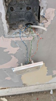

There seems to be only 1 cable fitted into the face plate. I also lifted a floor panel and I can access the cable going to the bedroom socket. It will be easy enough to splice a new cable on so I'm happy with that. I will need to lift another area of flooring to see where the cable actually comes from as it's definitely not the master socket in the livingroom.
There's no water ingress under the floor and it looks like it's free of any mice, is there a recommended type of connector I should use?
Thanks again all.

the certainly looks like just an extension socket.  be helpful if you can find where the main openreach cable enters your home.
have you checked to see if your property can get FTTP?  just enter phone number or address and post results
if FTTP available then fixing existing wiring not needed
you could just look at local paper and get a telecom person to sort out wiring if needed and probably quicker and cheaper than openreach

Best splice is solder and heat shrink. If that's not your "thing" maybe its time to learn 8-))

To join the thin phone wires I would use small gell crimps. Easy to get and easy to use and neat job

If I interpet the picture correctly, that's 6 cores from a single cable that run to the bedroom socket. You cut through each and, mysteriously, your internet broadband went down, so you twisted the cut cores together again and your broadband came back on. But, if your broadband router is plugged into a different socket in your lounge, that's impossible! Cutting the wires going to an unused socket should end you up no different from having the socket connected to the cores but not in use. There has to be another cable running from the bedroom socket to the lounge socket

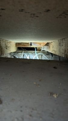

 Hopefully you can make it out but at the back right of the picture it looks like one cable come into the house under the floorboards and then splits into 2. One cable doubles back to the socket in the bathroom and the other disappears under the floor again into another room. I can't really lift anymore floor until I get a circular saw from work and cut a hatch. All seems a bit odd though.

Go to solution
