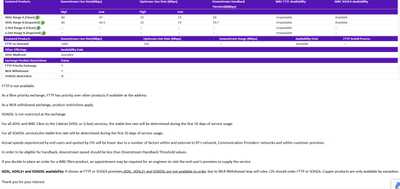

If your address appears on the Royal Mail site , it may appear here , (TBH , it probably does , otherwise you couldn’t raise an order , )
Does it show WBC FTTP , or just copper based products (SoGEA for  example)  , snip and post the entire return if you want an explanation of what’s shown.
https://www.broadbandchecker.btwholesale.com/
If FTTP is available very close by , it’s possible that when your general area was surveyed etc your address wasn’t existing so no capacity was provided for it , which could require incremental build to pick your address up , you can also fill in this formwize, there is a  section along the lines of ‘my neighbours can get FTTP but I can’t ,filling this in only worth doing if the BTw checker doesn’t show WBC FTTP .

Thanks for your reply. I've checked the BT Wholesale Broadband Checker and my address only shows SOGEA/copper-based products with estimated speeds of 67–80 Mbps - there's no WBC FTTP available. The confusing part is that I've previously placed a broadband order, but after multiple engineer visits nothing was ever installed. I own the property, there doesn't appear to be an Openreach master socket anywhere in the house, and no one has been able to explain exactly what's preventing the installation.
