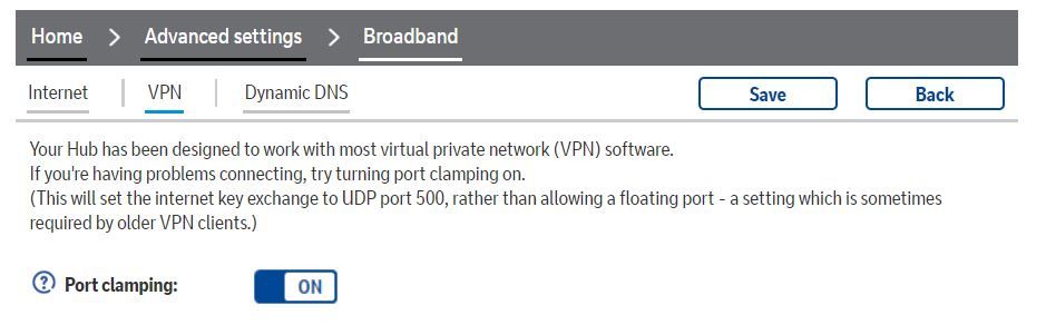

I had a similar problem using NordVPN & a 'work supplied' VPN service. Our IT department said that there did seem to be an issue with the SH2 and suggested turning on port clamping. This seemed to work then (at least 2 years ago) and I still don't have any problems with NordVPN. May be worth a try.
