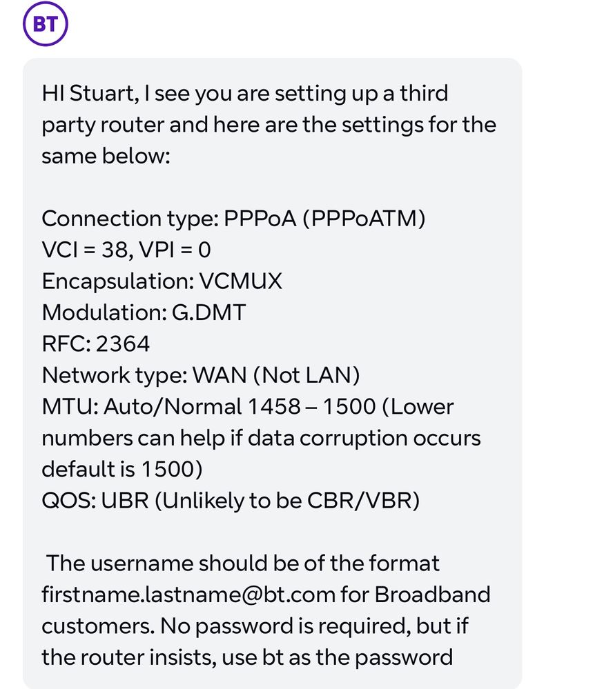

I have a five year old Linksys Velop system which I could not get to work with my new Openreach ONT. BT told me the ONT works with PPPoA, but the only option on the Linksys was PPPoE.
I then chatted with a Netgear support operative who told me that the Netgear Orthi RBK850 series supports PPPoA, happy days I thought but I could not find anything in the manual to confirm this, neither could I establish whether it was possible to connect satellites by Ethernet.
Has anyone out there got any experience of such matters and any suggestions please?

Total nonsense, FTTP is PPPoE.
Generic username [email protected] and password BT

Thanks for your reply!  I am confused as to why BT sent me this?
I am considering buying the Netgear Orthi 850, which the Netgear support operative said speaks PPPoA (the manual doesn’t mention it!) I just hope it all works seamlessly!

I don't know what idiot sent you that, but it is totally incorrect.
The settings are as per my previous post.
PPPoA is only used for ADSL, not VDSL or full fibre.
