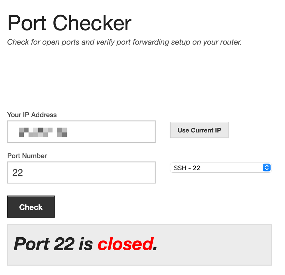

Here's the result of a port check

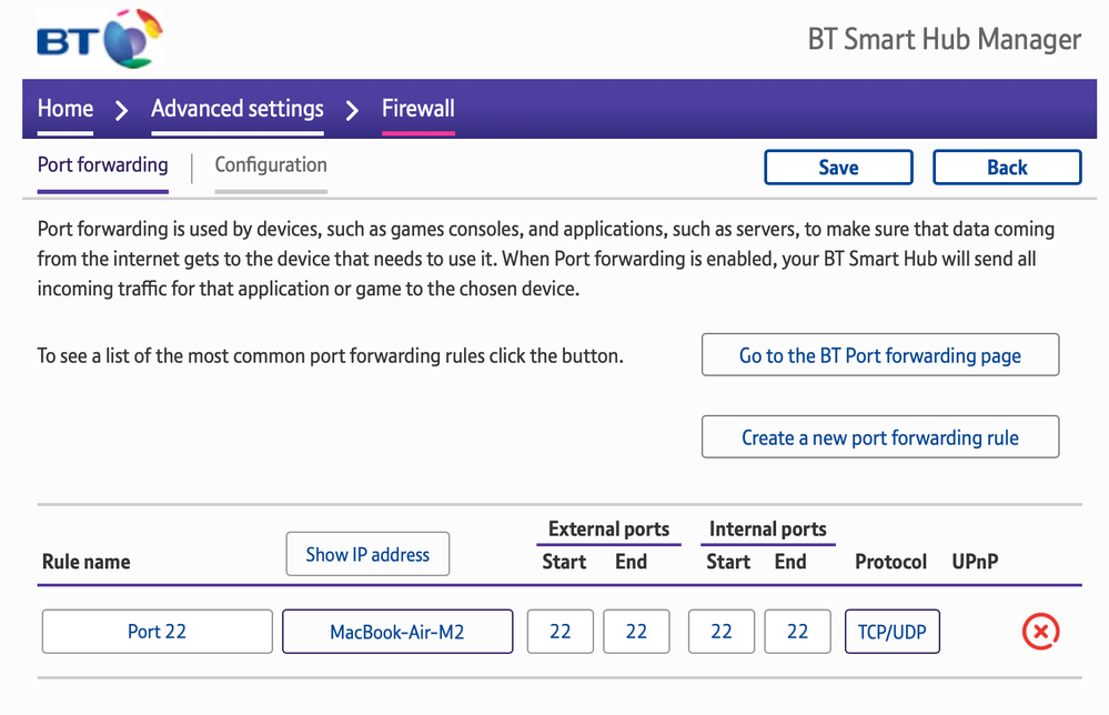

And here is the useless forwarding rule

It would appear from your first post that you are attempting to make an outbound connection rather than an inbound connection to a server on your network. That being the case, port forwarding and putting devices in the DMZ is pointless and won't have any effect as that is just for inbound connections.

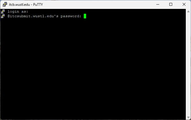

I suspect the problem lies with distant server possibly rejecting the connection due to IP address.

Port 22 works just fine for me.
There are a list of servers you can test to here to verify if it is just your server rejecting the connection.
