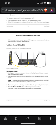

 The Network R7000 manual (see attached) says that the Netgear needs to be connected using a front end modem. The Netgear router does not have a modem in it. The BT Smart Hub 2 is a router plus modem. Are you sure that I don't need a modem alongside the router?
