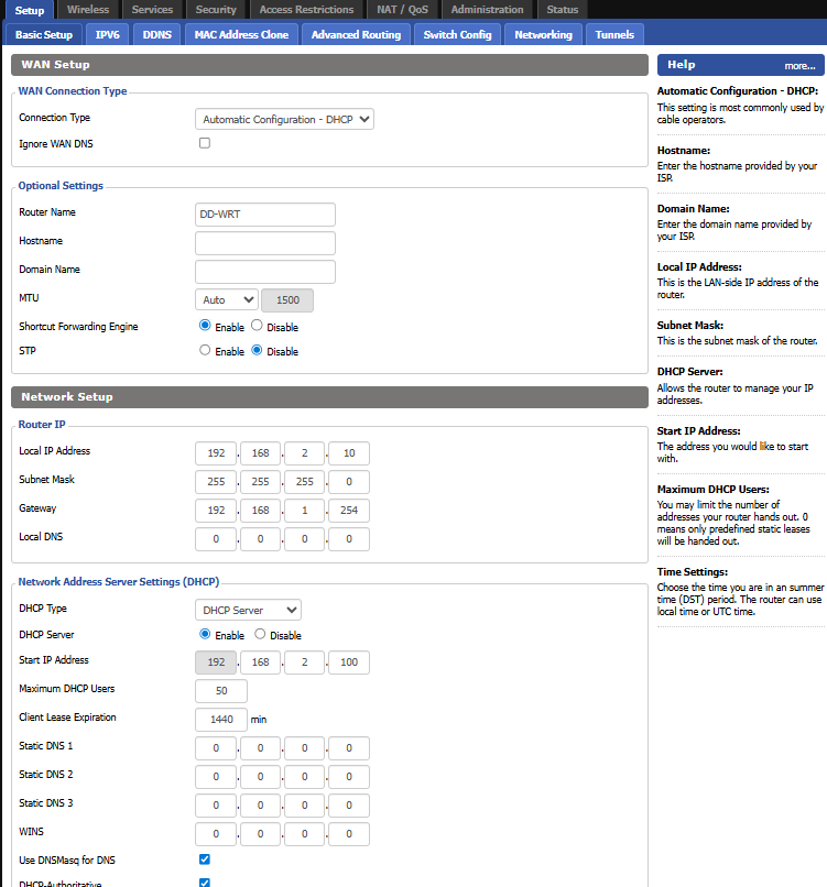

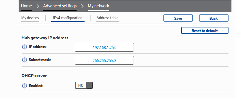

These are the settings I changed the Netgear (2nd photo) and the 1st photo shows the BT Smart Hub settings with DCHP disabled. This setup was with a ethernet cable coming out of LAN4 (BT Hub main) to the Internet Port of the Netgear. Although the Internet icon on the Netgear R7000 did light up I still could not access the internet through the Netgear whether DCHP was disabled on the BT Hub or not. What am I doing wrong?

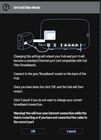

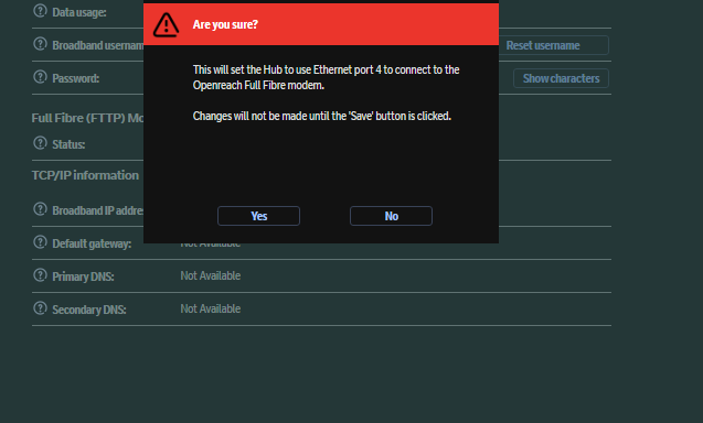

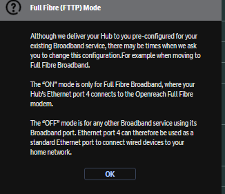

1. I use Openreach Full Fibre so the 'Full Fibre' has to be on (see screenshotted errors above). I did not get internet on the BT Hub when Full Fibre was disabled (no connection through Netgear) so I don't think I can disable Full Fibre on the BT Hub.

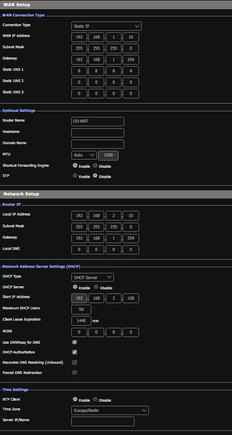

2. On the Netgear I did set the WAN Connection to Static IP and WAN IP to 192.168.1.10, then I set DNS to 8.8.8.8.

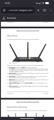

"You need to connect the BT hub port 1,2, or 3 to the WAN port of the Netgear."      I did that and I still had no internet connection on my Netgear. The setup I tested last night was: Port1 (BT modern) to WAN port (Smarthub). Then LAN2 (Smarthub) to Internet port (Yellow) of Netgear (see pic).
1439.pngAlso the Netgear manual says that when setting up manually 'Use Static IP Address: Enter the IP address, IP subnet mask, and the gateway IP
address that your ISP assigned. The gateway is the ISP router to which your router
connects. ' So the gateway should the the IP address of the BT Hub so 192.168.1.254?
