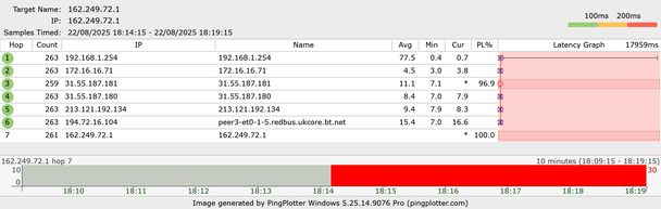

I have been in contact with Riot Support for 3 weeks and they have narrowed the issue down to it being due to a routing issue and they claim this is why I am unable to stay connected to their servers.  The error code I end up with when I disconnect is VAN-72. They have made me take a PingPlotter test and this is the most recent one which I sent to riot support which they believe verifies its a ISP issue and not due to their server.
This PingPlotter test was taken when I was inside of a custom game and crashed within a minute in
This is what Riot Support had to say:
"Taking over from ***** to say that you can send your ISP the Ping Plotter results, so they can see them and the packets loss too. The gist of it is that the 3rd hop has almost all of its packets lost (the big red bar shows it) and to simply ask for a reroute, as that'd let you bypass the massive packet loss there. Telling you this, cuz we only take care of the last hop which is always shown as 100% packet loss, despite that not being the case."

@entrophy I've seen someone report similar issues very recently - they fact that the last such entry on these boards dates back to 2023, makes me think it may have been on a different forum.  So working from memory Valorant/Vanguard have had issues with NAT types, so double natting (one router behind another) can be a problem, as can using routers that use the mobile phone network.  However, I believe the issue has still reared it's head even without those situations being present.
The games running fine here (they do), does not mean that I don't believe you!
There is a problem though with the level of understanding that the Riot games support team has regards ping-plotter!  If you get no packets reported at an intermediate stage it does not mean that the data is being lost at that node, just that the node is not responding to pings!  If I've 100% loss at step 4, but 0% loss at step 5, then the methodology is wrong!  *Ping-Plotter can be a great tool when used correctly, just it can be very easy to jump to the wrong conclusions based on it's output!

There is absolutely nothing you can do as an individual. BT will not investigate a supposed routing problem reported by an individual customer.
The supposed packet loss at node3 is just that node having better things to do than respond to pings.
It could still be a symptom of a problem, but you are not losing packets. Packets can't miraculously be recreated at the next node if they are lost.
