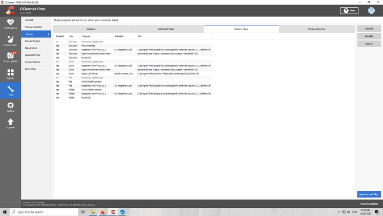

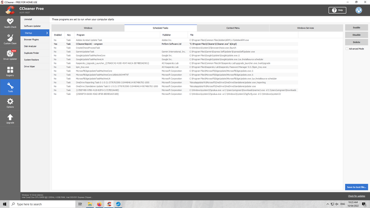

These are the rest. On reflection, not that many now running.
4,314 Views
Message 22 of 29
Re: Router compromised?
Go to solution
Is it running any better?
