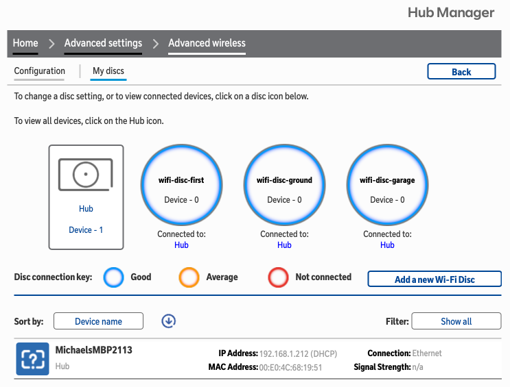

I had hoped to link up the old BT Whole Home Wifi discs that work just find on the old Smart Hub 2 (see attachment) but I can't get them to pair with the new 5G Hub using WPS.

The WPS section in the hub GUI states the opposite - initiate on the hub first, see attachment. I can try the reverse order but don't hold out much hope.
