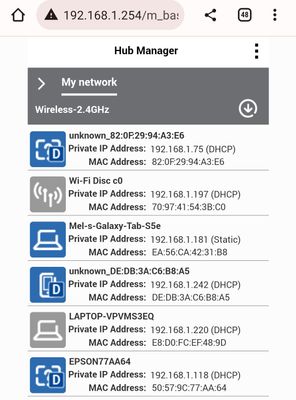

Been having some issues recently with the stability of the line so I decided to login into the admin page of the hub. To my surprise though I see network details (SSID etc) which aren't my own. I click through to the connected devices and I see my neighbours phone tablet etc.
  • If I refresh the page it seems to revert back to my network again with my devices etc. Has anyone seen behaviour like this before? Strangely the first SSID in the picture doesn't seem to actually exist

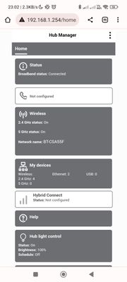

Additional screenshot from the devices page. These are my neighbours devices (they have never been inside my house)
