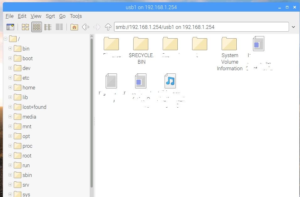

Just connected fine from my Raspberry Pi using anonymous login via smb://192.168.1.254/usb1

Just navigated to it via file manager

Must be finger trouble here - solved. Many thanks.
