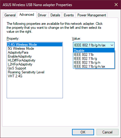

If you need your PC to connect only to 5GHz then you can set this in its device properties.  The issue you can fase if you do this though is that if the router uses "high" 5GHz channels, then these can drop if DFS (radar) is detected.

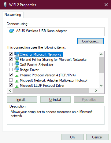

So from the above dialogue you'd follow properties to:
Then configure under the wireless adapter name:

My MediaTek options look a bit different, but it was already set to only 5Ghz.  I've re-enabled the 2.4Ghz on the smart hub 2, lets see if it jumps again.

Once 2.4GHz is disabled on the adapter it won't jump, but if do happen to be in an area where DFS (radar) is an issue and you use those channels, you'll potentially lose your connection altogether for up to 10 minutes at a time!
